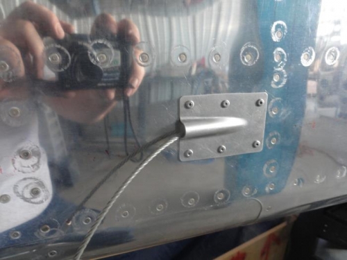

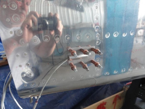

Date:  7-11-2014
Number of Hours:  3.00
Manual Reference:  38-8.2 and .3
Brief Description:  Install aft rudder cable guides and fairings
It took a long time to do a little bit. Fishing the adel clamps into place in the tail cone was difficult. Getting the washer and bolt in place was horrible, but I finally triumphed. With the guides in place, I drilled the fairings and pop-riveted them in; that was a piece of cake. I'm also still trying to get the A/C hoses assembled without any luck.
