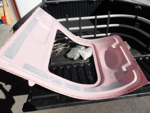

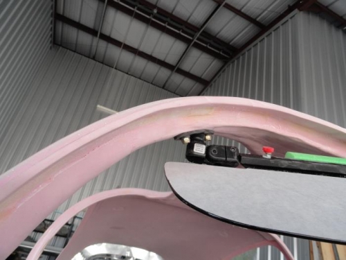

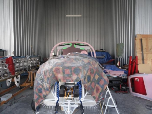

With the second door bonded I removed it from the fuselage and trimmed near the scribe line. I also took the time to measure and mark the cut line for the pilot's side door opening before cutting the opening out. Now the major portion of the cutting is done and it's time to start sanding to fit. Tired of glass work, I fitted the Rosen visors to the cabin frame. They sent me #10 screws but #8 nuts; no big deal, I just substituted my own for them. This is just a test fit anyway to get the holes drilled; now the shades will be stored away until after the interior is done and they can be permanently installed.
