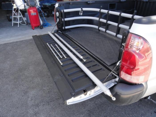

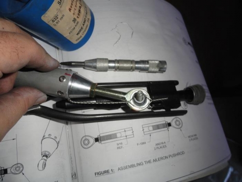

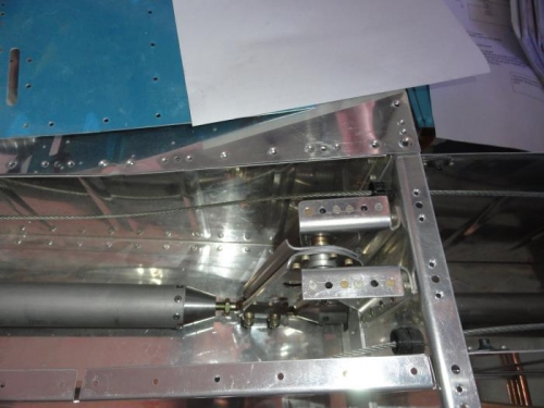

Brief Description:  Control System pushrods
Made up the pushrods for the control system. The tubes are primed inside but not outside because these are easily inspectable though I am considering painting them before final assembly. You can see that I made up the capture safety wire loop in Image 1. The idler arm was also constructed and then the pitch pushrods were installed. I looked at the joint between the control sticks and the base but had some questions so I stopped there.
