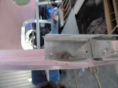

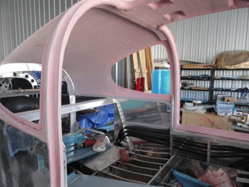

Brief Description:  More cabin top trimming
Now I could redraw the lines aft of the door area and retrim them, as well as trimming the forward posts to clear the front deck skin. I also radiused and notched the lower door frame per the plans. The only remaining problem is the forward post which is holding the cabin outboard about 1/4" and will have to be trimmed further. Tomorrow I should be able to finish that trimming and drill the attachment points.
