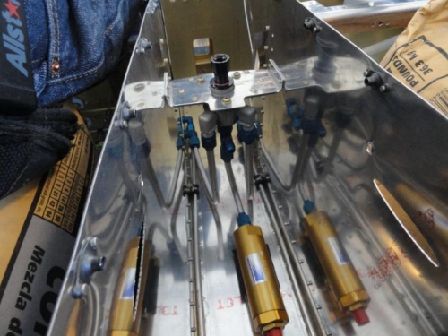

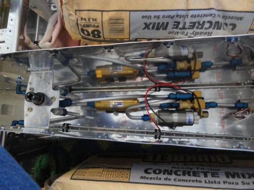

Brief Description:  Install fuselage fuel system components
Fabricated the cushions for the fuel filter and pump and installed them with Gorilla Glue. Bolted the Flow-Scan in place and placed the filter and pump in their locations. Starting at the elbows aft of the fuel selector valve, I fabricated the lines to the valve. Then I installed the swivel-Tee to the valve and fabricated the line to the filter. Next, I fabricated the short lines between the filter and pump and the pump and Flow-Scan. With those in place, I installed the clamps to hold the filter and pump. Finally, I fabricated and installed the return line and the line from the Flow-Scan to the firewall.
