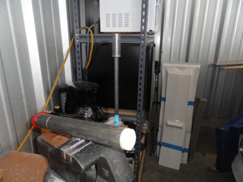

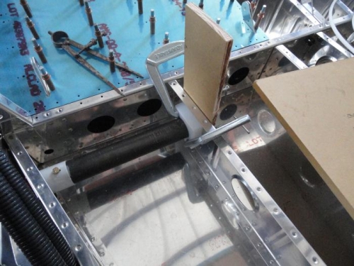

So I took the pictures from yesterday and then a picture of one of the plugs and the jig for pushing it to depth in the step tube (see Image 3). Then I set about finishing the left step, which involved pre-drilling the inboard mount and then positioning it and final-drilling it to the rib. After that, I installed the bolts, torqued them, and then installed and torqued the bolt for the step mount.
I started the right step with the inboard mount, in the same fashion as the left side. I didn't notice a difference between starting with the step bolt or the inboard mount other than the right side seemed a little easier. In any case, with the mount bolted and torqued, I positioned the step and jigged it in similar fashion to the way I set up the left step. Once jigged in place, I used the drill guide to drill the step, then removed the step so I could remove the guide before replacing the step and installing and torquing the bolt.
