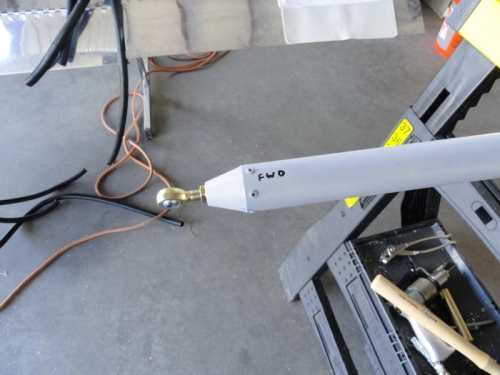

Most of the time was spent in the fabrication of the F-1091 pushrod as detailed on plans page 11-6. I used a chop saw to cut the tube to length and then polished and deburred the ends with the scotch-brite wheel on the grinder. Next I made a paper drilling template and marked where the rivets would go and then tapped the threaded end caps in with a rubber mallet and drilled them in place. I used a rod end and a long AN3 bolt as a T-handle to pull the caps back out, after marking them so I could return them to their drilled locations. Then I primed the inside of the tube and the caps, replacing them wet before pop riveting them in place. Finally, I primed the outside of the pushrod assembly,

I also mixed up some Proseal and glued the static ports in place; holding them in with tape while the Proseal sets. Finally, I began the planning of how to mount the Andair fuel valve. I am hoping I can score an unpunched valve plate from Van's; otherwise I will have to rivet a mounting plate to the existing mount. In any case, with the primer finally dry, I installed the rod ends and jam nuts, set the initial length of the pushrod per the plans, and set it aside. I then stopped to help another pilot troubleshoot the turbe system on his Aztec.
