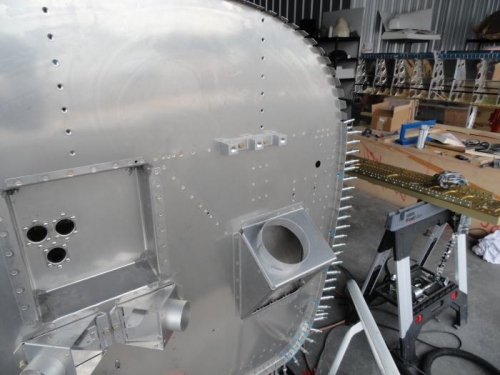

Brief Description: Match drill forward left side skin

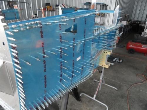

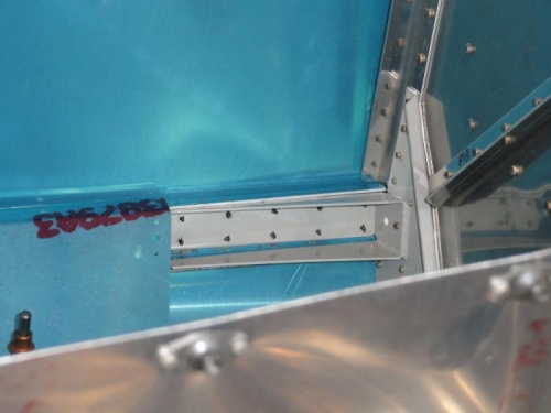

I enlisted help from Phil Cobbin to drill the lower firewall weldments to the left and right forward skin. We took a long 1x2 and he stood on the opposite side and pushed the weldment ear against the skin while I drilled. With that done, I could continue to do the other side by myseld, like yesterday. I match-drilled all the skin holes and then I match-drilled the #30 holes for the top channel on both sides. I clamped the longerons and channels to the firewall brackets in preparation for removing the skin and match-drilling the structure. I didn't have enough time to start in on removing the skins because I was going home to make sukiyaki for Judith, so I finished the day by installing the sender manifold to the firewall. That simply consisted of using two AN3 bolts and washers into the nutplates on the firewall and torquing them.
