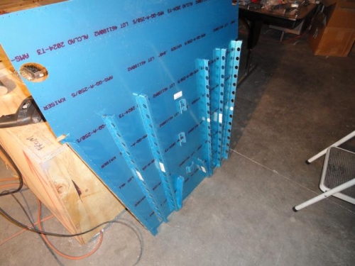

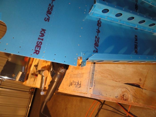

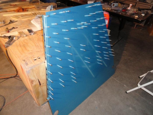

Brief Description:  Assemble forward bottom skin and stiffeners
Clecoed the floor stiffeners to the forward bottom skins. Trimmed the outboard stiffeners using the guide marks provided. Added the fuel system mounts. Match-drilled all the clecoed parts. Drilled the brake line exits to 5/8"
