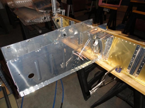

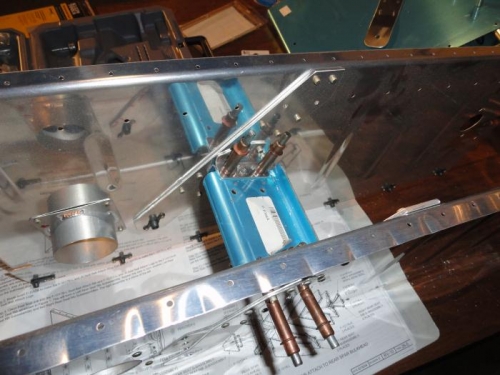

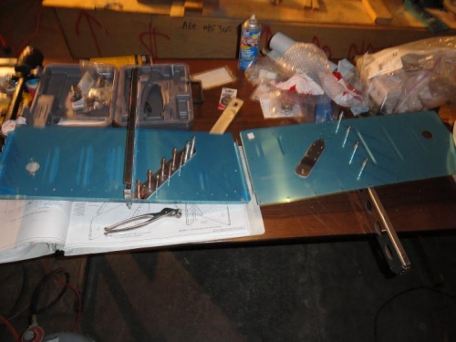

So, I trimmed the seat belt bars and then assembled the outboard seat ribs before match drilling them. Then I moved to the flap motor bracket and trimmed the parts, smoothing and deburring edges. Once the bracket was assembled and drilled to the inner seat ribs, I attached the assembly to the rear spar and match drilled the inner ribs.
