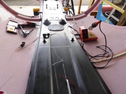

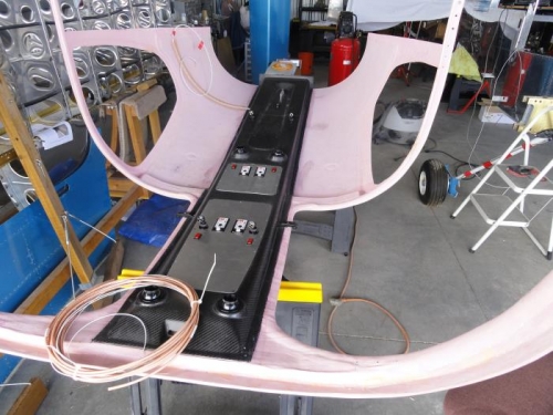

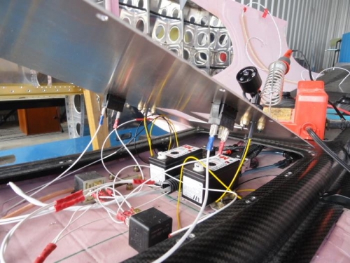

Brief Description:  Finish wiring the overhead console
With the console in place, I could finally complete all the connections in the overhead. The exception is the speaker, which will have to be connected when the cable is routed up from the panel. The switches merely required pushing the spade connectors into place. The forward left switch interfered with an antenna cable, which was fixed by bending the connections about 30 degrees. The wiring from the lights was all pretty fine and I also wanted them to thread through the small openings in the overhead, so they were soldered and covered with heat shrink instead of the crimped connections used everywhere else. Continuity was tested on all the circuits and then the excess wires were coiled.
