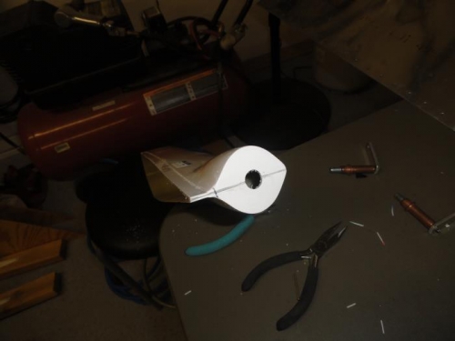

Brief Description:  Wire leads for trim tab servo
