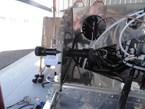

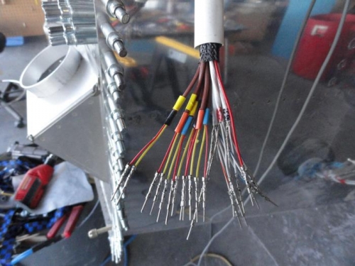

I installed the left side firewall plug by putting the bulkhead piece in the hole I previously punched and installing machine screws and nuts to hold it in place. In Image 1 you can see the other plug attached and both backshells, showing why I had to move it above the engine mount so the backshells wouldn't interfere. Then I began crimping the pins for the harness. The extra wire was labeled but I wouldn't have room for that in the backshell so I used color marking, noting the colors in the diagram from Aerotronics. I won't install the pins yet, as the panel still has to come back out so I can rivet the deck skin.
