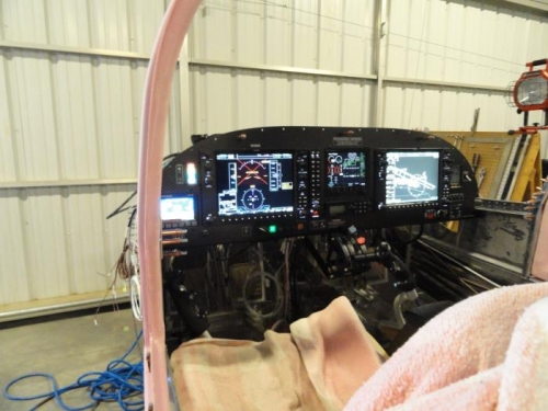

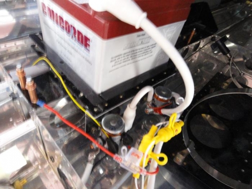

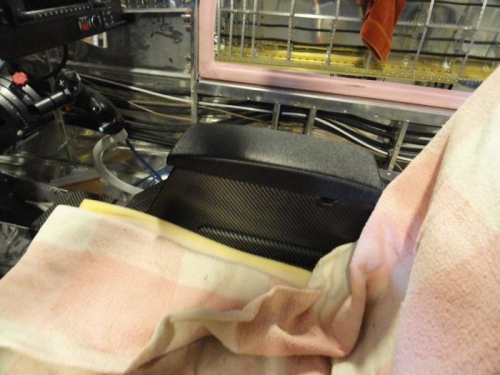

Parts arrived Friday but we had a Young Eagles event on Saturday so it had to wait until today to re-install the power circuits with boots. I still need to make a ground connection for the ground power activator and make a clip for the overvoltage unit. But I was able to power the unit on and test the basic panel operation (VP-200 correctly sensing, and test the G900X reversionary mode, plus test the Dynon backup operation). I let it run a bit to drag the battery down and then tried the ground power unit only to find the fuse blown. I replaced the fuse, looked for problems, and then tested the ground power as it recharged the battery; it went the full cycle without blowing the fuse so I may have just had a poor or shorted connection last time. Keeping an eye on it for problems goes on my list. Just for fun, I also test-fitted the center console which also arrived Friday. It's nice! I will need to fix its position so I can run the headphone connections to it.
