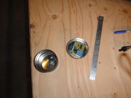

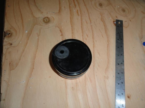

I also spent a bit of time on the controller. One of the things they tell you is not to let the board short out, but they have you leave it uncovered out in the wing where condensation, dirt, debris, etc. can get to it. I located a scented candle last X-mas that came in a conveniently shaped tin, so I rooted the candle and its packaging out. I fit the board inside the lid (it's shallower so you get better access to the wiring) and drilled for the screws and spacers). I then fit the other half and drilled through both #40 180° apart so I can use a spring wire bail to secure the cover. I also located the hole for the wiring and drilled for a rubber grommet. Finally, I added a drain hole at the bottom. The tin just fits in a rib lightening hole, which I'll back with aluminum to mount the tin. All I need to do now is fab that mount, prime the tin, and make the wire bail.

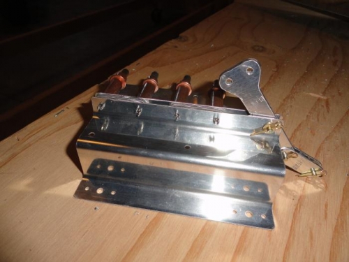

While I was at it, I made up the parts for the aileron trim. It was too windy to prime but I went ahead and roughly assembled the parts after cleaning them up and deburring.
