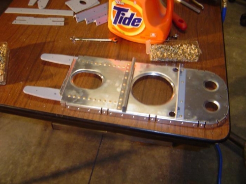

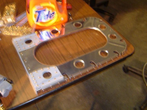

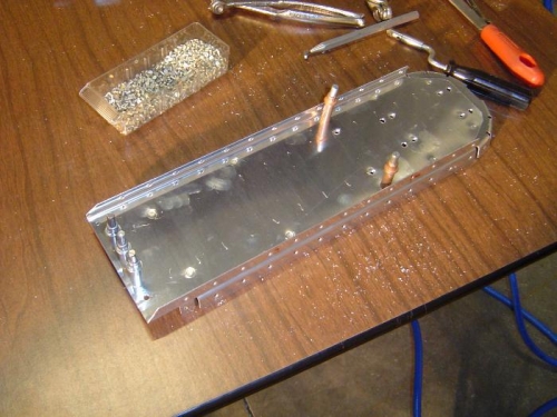

Brief Description:  Riveted last three tailcone bulkheads
Primed all the parts finished yesterday. While waiting for primer coats to dry, I cleaned up the edges and deburred the remaining parts for the F1012, F1011 and F1010 bulkheads. Then I dimpled the flanges and also the webs of the F1012 bulkheads as specified in the plans. Next, I riveted the F1012 bulkhead together and then added the rudder stop brace and the tiedown block. After that, I riveted the cross pieces to the F1011 bulkhead and finished with the F1011-C bars. Finally, I riveted the angle and reinforcing plates to the F1010 bulkhead.
