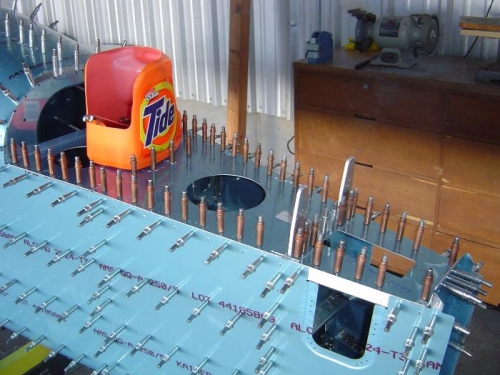

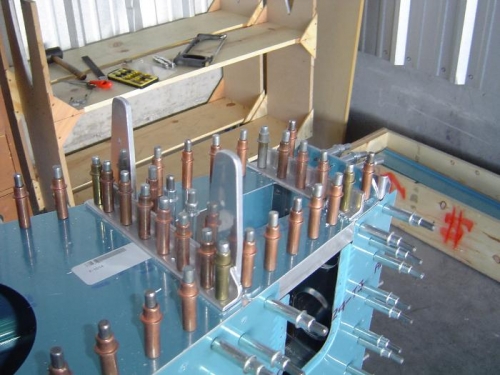

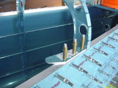

Brief Description:  Installed the rear deck
Fabricated the F1011D and F1012D brackets. Drilled the aft deck to the longerons, added the brackets and drilled them to the structure. Located and drilled the #12 holes. Removed the top skins and located the seat belt anchors. Drilled the anchors to the longerons. Drilled the screw holes for the inspection covers and then the nutplate holes.
