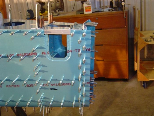

That out ot the way, I finished match drilling the bottom skins to the bulkheads and each other. Then I installed the F1009 bulkhead and pre-drilled the ends of the last three stringers (I should have done this on the first ones; it makes positioning them much easier). I added the aft top skin and clecoed it to the side skins and bulkheads. Then I drilled the stringers and finally match drilled the side skins and aft two bulkheads. Next, I added the forward top skin and match drilled all the stringers, side skins, and the rear bulkhead.

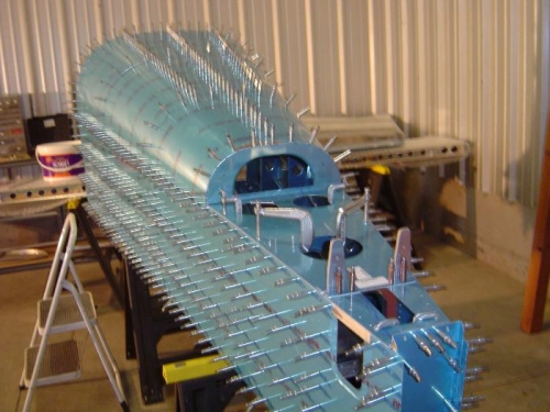

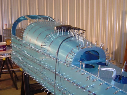

I followed the instructions and heavily fluted the two-hole tabs, despite misgivings. It seemed to work out well, though you can see from the second picture that the clecos in the bulkheads tended to be non-perpendicular to the skin. After match drilling, the clecos oriented normally (as the third picture shows) and the skins were drum tight.
