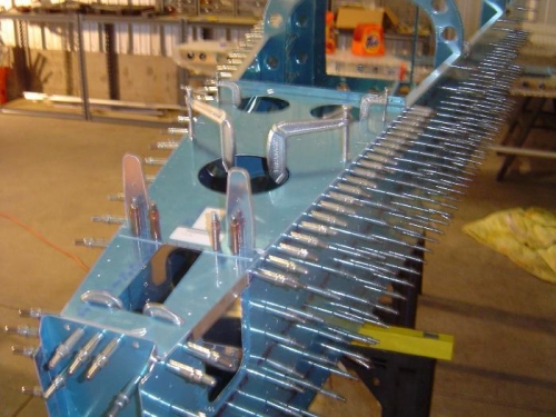

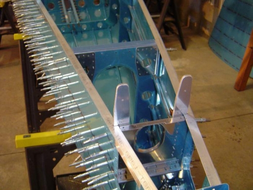

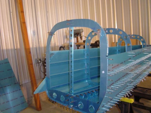

Brief Description:  Added longerons, rear deck
Added baggage bulkhead channel and final drilled #30 holes in F1006 bulkhead. Added bellcrank rib angles after final drilling the appropriate holes per the instructions. Fabricated the rudder stop brace angle and clamped, then drilled, into place. Took a break to fly to Kidwell (1L4) for breakfast in the RV-6A (boy, was it windy and cold today) and then returned around noon to continue.
Fabricated the F1010B spacer and positioned the spacer and longerons per the instructions. Added the Aft Deck and Elevator Stop/Doubler and clamped everything in place per the instructions. Starting at the rear, drilled the side skins to the longerons.
