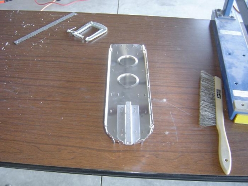

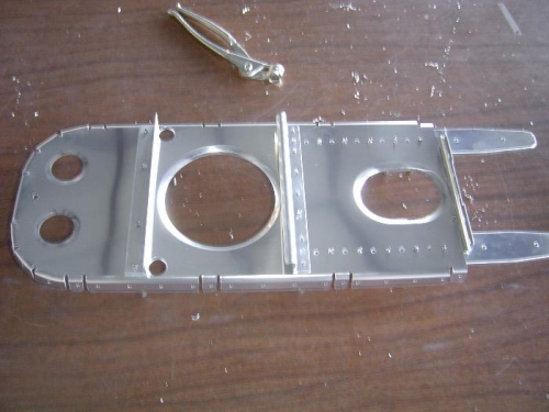

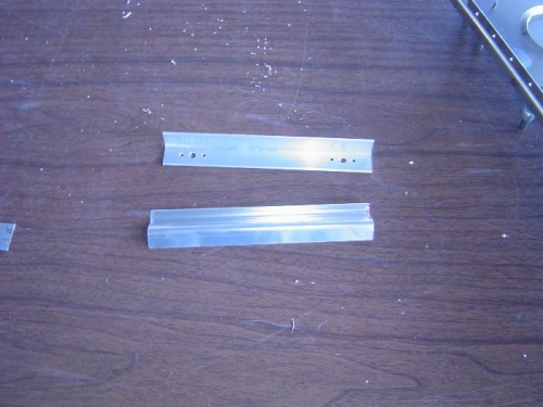

Brief Description:  Assemble the rear two bulkheads
Trimmed the tiedown block and tapped for the tiedown per the instructions. Assembled the F1012 bulkhead and then located the tiedown block and drilled to the bulkhead. Cut the cross pieces and drilled the angle for the AN-3 bolts and nutplates. Straightened the HS attachment bars, polished them, and drilled them to the F1011 bulkhead. Drilled the cross pieces to the bulkhead and drilled the 5/8" holes for the rudder cable fairleads.
