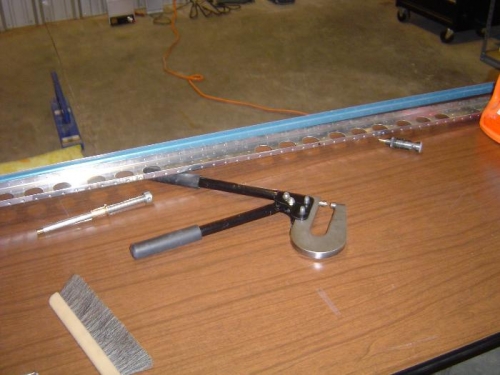

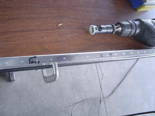

Continued dimpling the remaining elevator skins. Finished deburring the remaining parts and dimpling the forward spars. Discovered that the dimplers I have on hand won't work for the rear spar and inboard rib, so I placed a set of vise-grip dimplers on order. Countersunk the rear spars at the 29 locations called for to accomodate the trim tab hinge.
