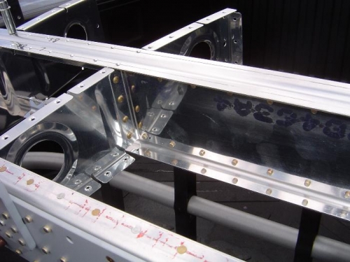

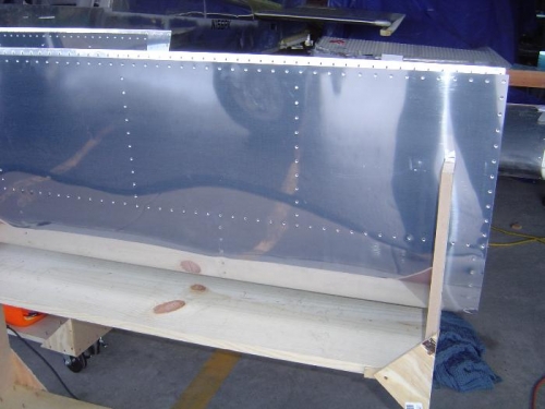

Brief Description:  finished dimpling and riveting HS skeleton
Dimpled the inspar ribs and counter-sunk the flanges of the forward HS spar and stringers. Riveted the stringers and riveted the stringer web to the inboard ribs. Riveted the stingers to the stringer web. Riveted the inboard inspar ribs to the forward spar. Riveted the nose ribs to the skins. Inserted snap-bushings in the forward spar.
Rivet count: 154 Total: 1215
