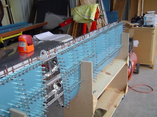

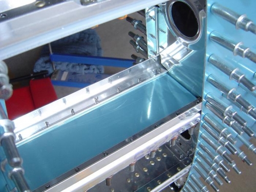

Brief Description:  Clecoed skin to HS skeleton
Inserted previously made-up stringers into the skeleton under the skins. Clecoed the skins to the stringers and skeleton. Added the rear spar and clecoed to the ribs and skin. Clecoed the stiffener web in place. Ready to final drill skins next session.
