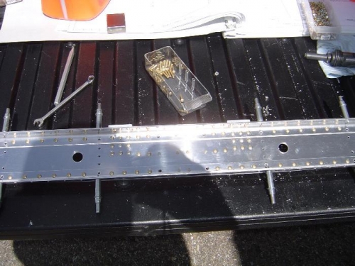

Brief Description:  Assemble HS skeleton and begin skinning
Finished deburring HS-1002 and primed the brackets and spar doubler. Riveted the forward spar together. Deburred all the nose and inspar HS ribs and modified the four inboard ribs per the instructions. Also modified the inboard nose ribs for the trim cables. Assembled the ribs to the forward spar. Then deburred the skins and put them in the cradles. Next, the nose ribs were clecoed into the skins and finally the forward spar, with inspar ribs attached, was clecoed to the nose ribs and skins.
