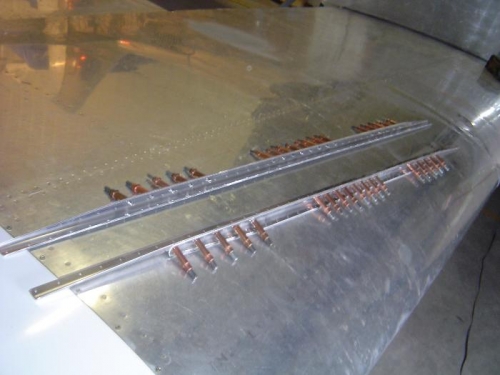

Brief Description:  Deburred spar cap strips
Filed the last little bit where Phil Cobbin had milled the ends of the strips, so the notches Vans uses as marks were completely removed. Then smoothed and deburred all edges on the scotch-brite wheel. As you can see from the picture, I also clecoed the strips together making up the inter-spar stringer for a later step.
