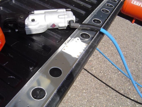

Brief Description:  Rivet rear spar and hinge brackets, fab forward br

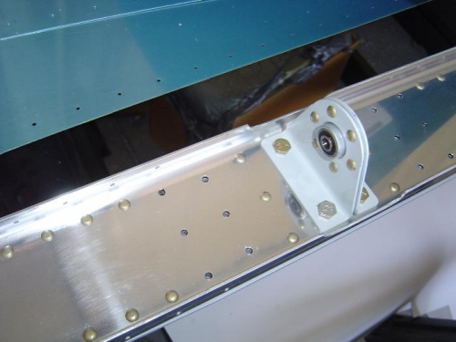

Riveted doubler to rear HS spar. Riveted hinge brackets to spar. Assembled and riveted VA-146 and brackets. Bolted bearing assembly to rear spar and torqued 20 in-lbs, applied torque seal. From the AA6-187x2x2.5x5 piece of angle, I fabricated the HS-1008 L and R per the plans, polished the edges, and drilled the holes.
Rivet count: 74 Total: 496
