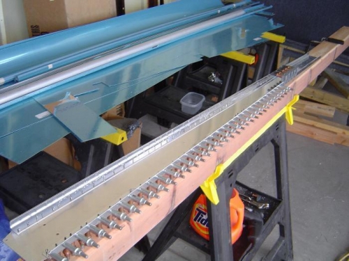

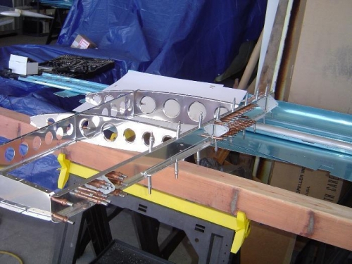

Assembled rear spar caps to HS rear spar
Nested the rear spar caps with the VS-1003 rear spar and drilled per step 2. Deburred and clecoed back together. Also polished inner edges of VS-1008.
