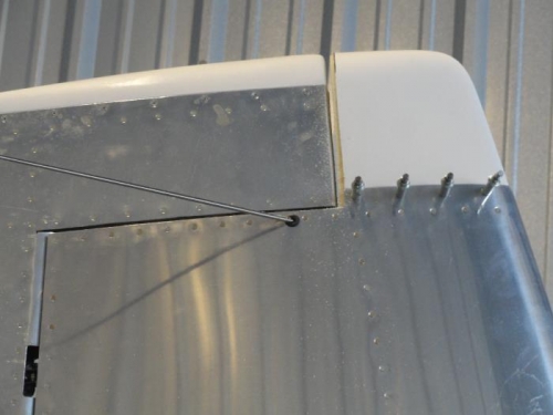

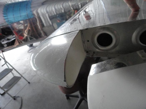

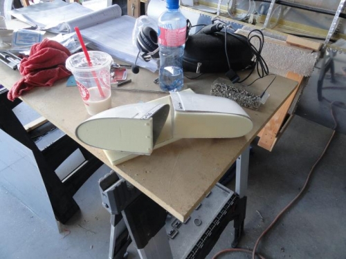

Brief Description:  Close rear of HS and VS fairings
Having received some open cell foam yesterday, I carved the end pieces into shape and glued them into the tip fairings. Then I smoothed them out in preparation for glassing over them. On the right fairing, I took the opportunity to adjust the gap to match the left. I also closed the gap on the VS fairing to be a bit closer to the rudder.
