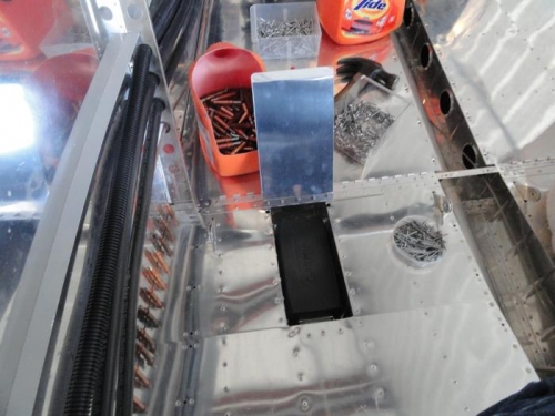

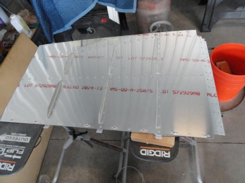

Brief Description:  Right baggage floor and seat pan

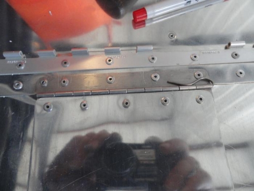

Dimpled all the parts for the right baggage floor (stiffeners) and rear seat pan. Then I back-riveted the stiffeners to the baggage floor and clecoed all the remaining parts in place. Next was a pop-rivet marathon after which I squeezed the rivets around the edges including adding the plate nuts. The last part was adding the AHRS cover. You can see in Image 2 where I added relief holes under the cover rivets where they would have interfered with the seat pan. The last image shows how I bent the hinge pin into a clip; I don't expect a lot of movement here so this should be more than sufficient to keep the pin in place.
