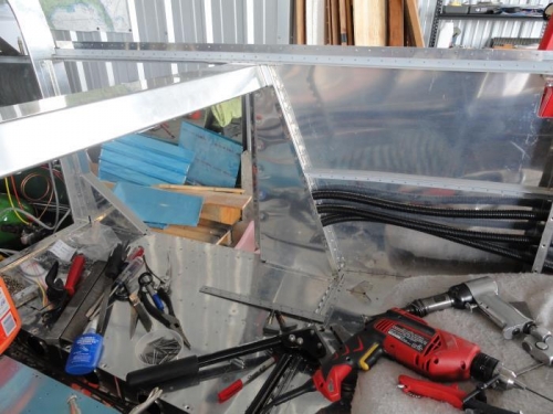

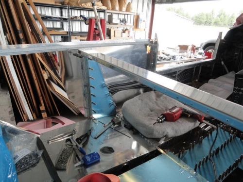

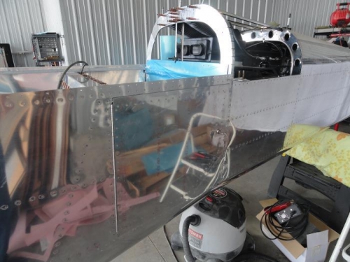

Brief Description:  Left baggage side and seat back closeout
With the baggage door done, I riveted the seat back brace closeout. Then I added the baggage side in front of the door. I deviated from the plans by dimpling the rear row of rivets and using CS4-4 instead of LP4-3 rivets.
