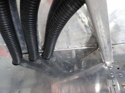

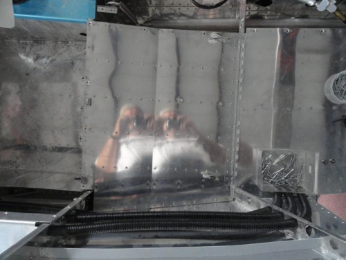

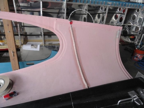

Brief Description:  left rear seat pan and glass work
The wire run from the baggage dome light to the switch inside the door needed to be secured to the cabin top, so I laid up a strip of glass tape over it. It will probably be a lump in a headliner but since it's in the baggage compartment I don't really care. Then I moved on to the rear seat pan and riveted all the rivets. I also added the rivets for the doubler in the baggage floor. You can see that it is beneath the floor instead of on top, both to finish up the cutouts for the conduit nicely and to prevent a raised edge in that corner. In my opinion, it looks good.
