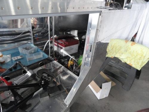

Brief Description:  Finish left baggage floor

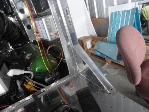

I finished riveting the nutplates for the left baggage floor. Then I moved on to the rear baggage door seals and installed them. Riveting the F-1026 was a real challenge; I had to uncleco the #30 clecos so I could twist the part and wedge my small tungsten bar to get the topmost and bottommost AN426 rivets. The rest was pretty easy, though.
