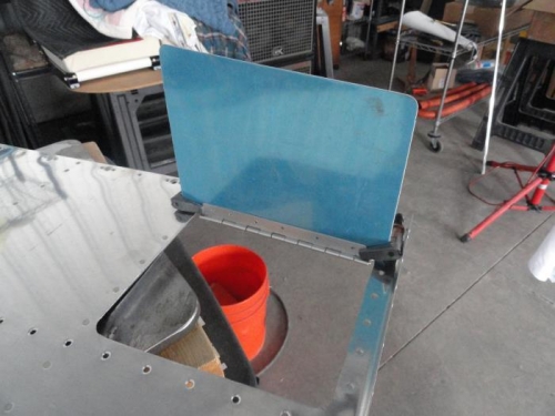

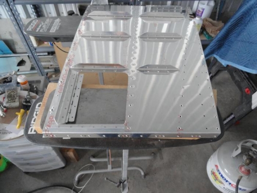

Brief Description:  Left baggage floor with access plate

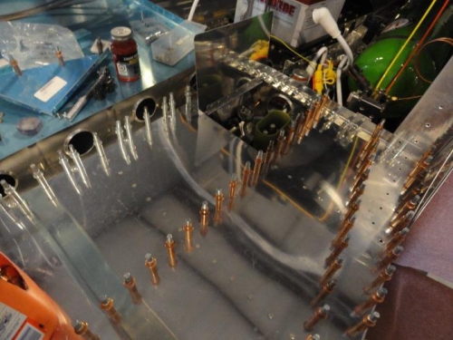

I riveted the stiffeners to the bottom of the left baggage floor. This included the two extra stiffeners for the opening to access the oxygen fill and ground power plug. I made up a flat door with half-inch overlap all around except the hinge side, and drilled it to the hinge. After dimpling both parts, I riveted it to the hinge. The third photo shows the assembly clecoed in place. It's a little difficult with the reflections and all, but the door is propped open and you can see inside the space. I need to verify the area under the rear passenger seat is ready to be closed before I rivet the floor in.
