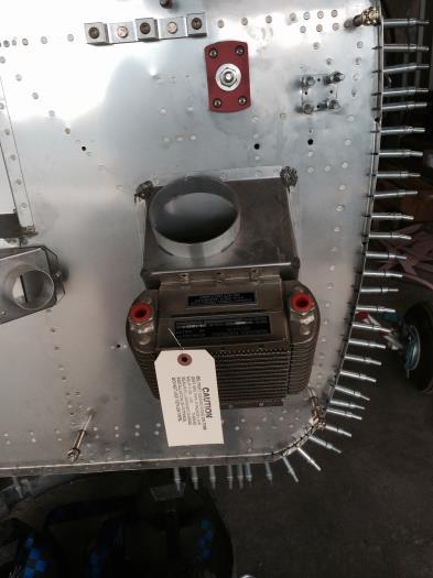

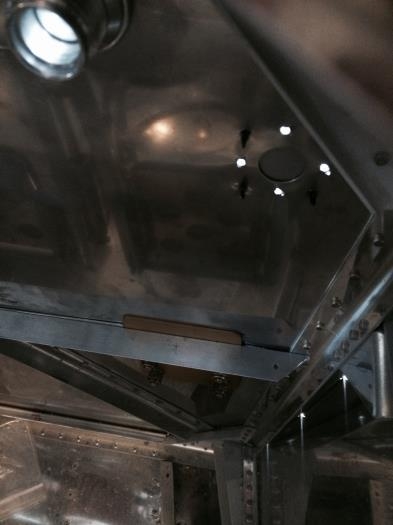

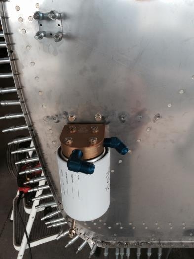

Brief Description:  Mod for remote oil filter
I'm installing an AirWolf vertical remote oil filter. With the mount in place, there is significant oil-canning on the firewall so I installed a cross-angle to support it, along with some spacer pieces to fill in under the angle since it lies on the doubler and the existing firewall angle. Once it was all riveted in place, the mount was bolted in and then I test fit the filter to see how the oil lines might run. While I was at it, since the Firewall Forward kit is here, I installed the cooler on the other side. It's been almost a year since I did any real work on this but the engine is on it's way and I need to get ready.
