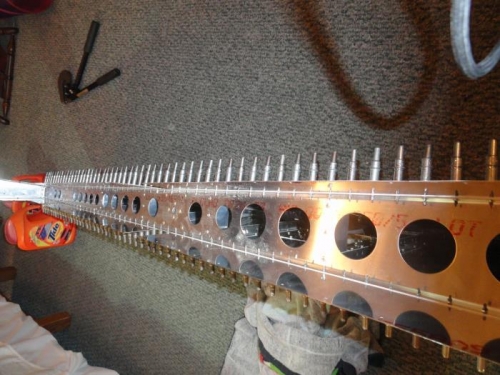

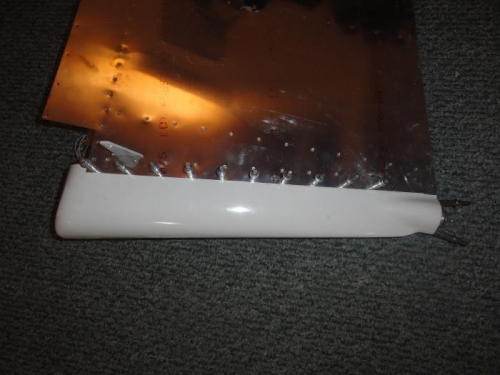

Not much to say here, just a bunch of pulled and squeezed rivets. Doing this in my living room, I thought I'd be safe but I managed to cut my foot on the leading edge. Never take shop work for granted. Once all the riveting was done, I trimmed the bottom fairing to fit and then drilled it into place with #40 drill. This is initial fit; the attachments will eventually be #6 screws and nutplates, with the skins dimpled and the fairing countersunk.
