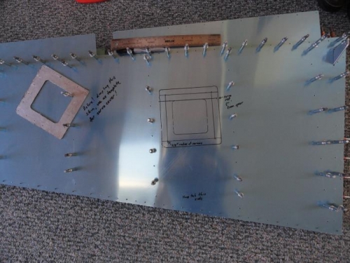

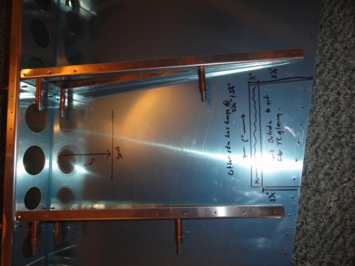

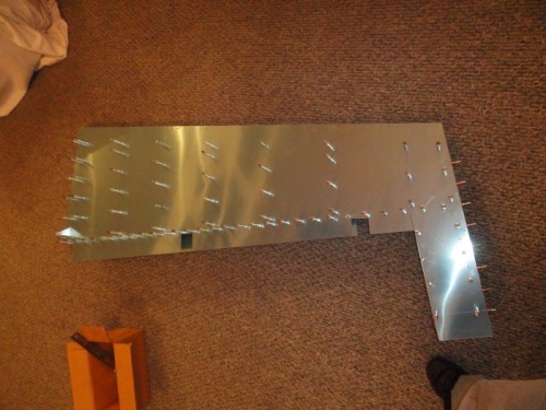

Clecoing the skins on would normally not be a section to itself, but this time I am preparing for the trim tab and servo before I do the riveting. I've marked the servo distance and the rough position of the tab inside the skin in Image 1. The vertical (relative to rudder) cuts in the skin for the tab will be marked and made before riveting and the horizontal cuts will be made afterward so the tab will have the same shape as the rest of the trailing edge. With the second skin on and using the doubler I made for the last rudder, I was able to mark the position of the opening for the servo as well as make a couple of notes to myself so I do things in the proper sequence. The formed trailing edge was also clecoed in at this time.
