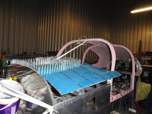

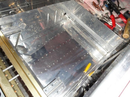

Brief Description:  install left rear floor, windscreen brace
I removed the left rear floor, dimpled it and removed the plastic, then replaced it and riveted it with the pop rivets; the dirven rivets will be added later. I also positioned the windscreen brace, clamped it in place at the top, shimmed the bottom per the plans, and drilled the attachment points. The aft hole is a bit close to the angle web, so I will add a platenut instead of using a regular nut. I deferred drilling the top bolts until I can get a drilling guide made to make sure the holes are perpendicular.
