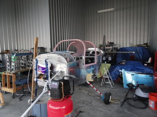

Number of Hours:  4.00
Manual Reference:  43-4 to 43-5
Brief Description:  Trim cabin cover to fit
The scribe lines turned out to be about 3/16" over so I spent a good deal of time sanding around the door openings to get the cabin top to slide down over the fuselage. That took a long time and I was covered with fiberglass dust, so I quit to shower the dust off before it brought on itching.
