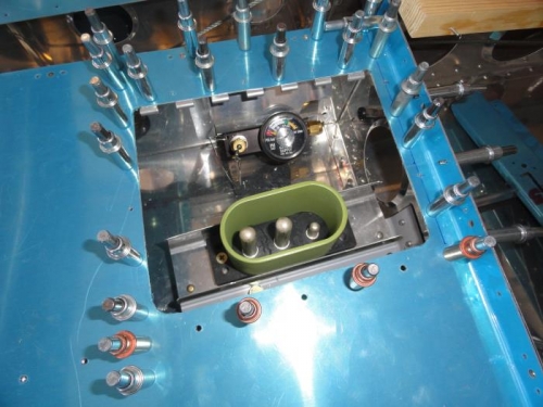

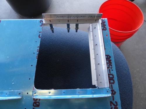

Brief Description:  Miscellaneous baggage floor plus mods
I began by fabricating an opening in the left baggage floor for the ground power receptacle and O2 filler. On two sides it uses the existing stiffener and rib and on the other two sides I have added angle stiffener and a piano hinge. The door will overlap the non-hinge sides; I won't worry about making it flush as it will be under carpet. Much of the rest of the day was spent in dimpling and peeling the plastic covering in preparation for riveting.

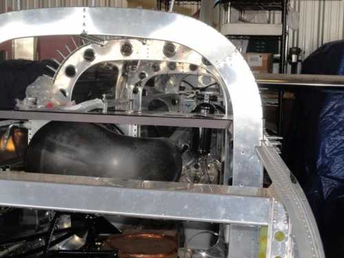

To give myself a break, I installed the package tray for the air conditioning and attached the cooler so I could see about finishing the hoses and remove the excess from the tail cone. A dilemma presents itself; I don't see how the cable for the right shoulder harness will get past the cooler. Time to ponder...
