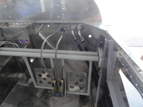

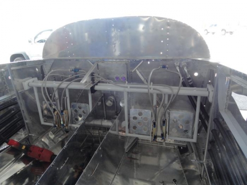

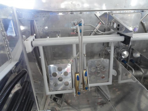

Manual Reference:  38-6, 38-7
Brief Description:  Install rudder pedal brake lines
Not exaclty according to the plans. I ran the kit-supplied hoses between the left pedals and the brake lines. The remaining lines were replaced with braided lines from Bonaco, and the included fittings instead of the fittings intended for nylon lines. I also had to drill out the 1/4" bushing holes in the center support to replace it with bushings that the line fittings could pass through. I ended with a tidying-up with tie-wrap.
