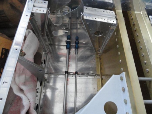

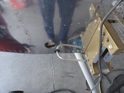

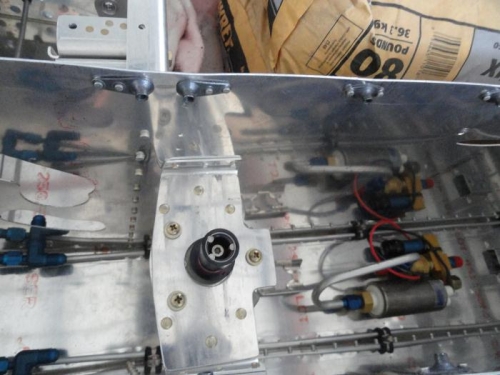

Brief Description:  Fuel System fabrication
Helping Judith pack, but snuck out for a session with the plane. I installed the Andair fuel vale and realized I need to get a swivel T fitting instead of the stock T from Vans. Oh, well, I'll order it on Monday and in the meantime, I can't plumb the valve. I installed the bulkhead fittings and then the fuel lines out the left and right side of the fuselage. I opened the fuel pump and found it didn't include the filter, so I will have to add that to the order. I also need to check with Aerotronics to see what fuel flow I need. I have an FT-60 on hand; otherwise I will have to get the correct sensor sent so I can finish the fuel system installation. I am also going to order the parts for the purge return to the right tank.
