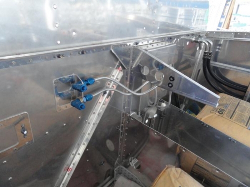

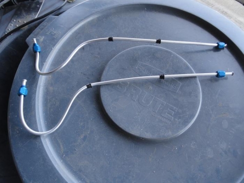

Brief Description:  Installed the fuselage hard brake lines

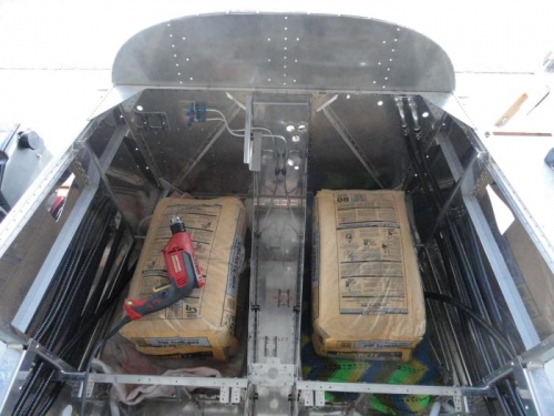

A whole section done today but not much to say about it. I followed the directions to the letter and had no difficulty other than the callout for a #8 screw on the firewall for the cushion clamp when the firewall section had me install a nutplate for an AN bolt. Yes, those are bags of cement in the front of the plane; they are standing in for the engine weight so I can have the fuselage on the gear. The only real innovation, if you can call it that, is that I am using AN plugs to keep bugs and debris out of the lines; you can see a couple of them in the last picture.
