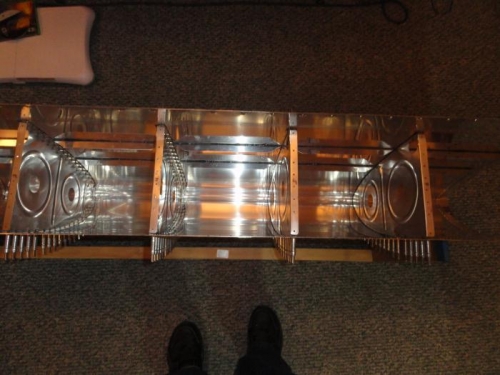

Brief Description:  Prosealed interior ribs in left tank

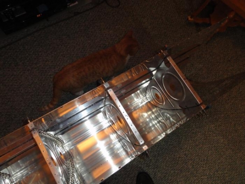

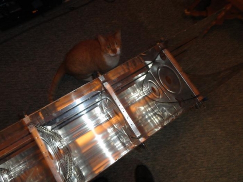

I cleaned the interior ribs (I still have some work to do on the end ribs) and prosealed them, clecoing them into the tank skin. Once done, I set them in the jig to allow the Proseal to set. I'll rivet tomorrow while the proseal is still soft and dab over all the rivets with fresh Proseal. No job is complete until an inspector looks it over and I'm not sure whether Pip Squeak approves. I think the verdict was 'Stinky'.
