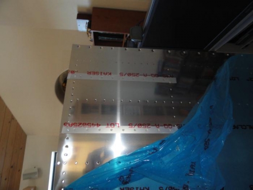

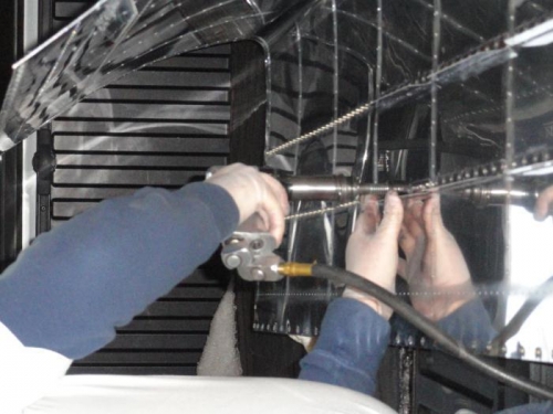

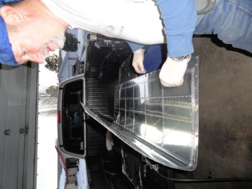

Brief Description:  Prosealed and riveted stiffeners
I cleaned the skin and stiffeners with naptha and then inserted rivets where the stiffeners would go and held them in place with riveting (removable) tape. Then I mixed up 2.2 oz. of Proseal and back-riveted the stiffeners to the skin. This was done in the garage and then the work was immediately brought inside to stay warm while the Proseal sets.
Rivet count: 126 Total: 14750 - Plus 549 done at Van's
