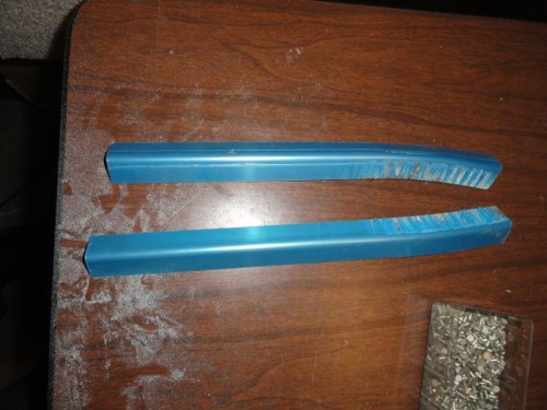

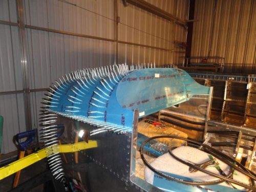

Last time I said I was unhappy with the F-1003D and E fluting to get the curvature. Today I set up the bench shrinker and the results were much better - a flange that lays flat to the instrument panel and a curvature to match the top of the panel. Only took a few minutes. This is the way to do this part. After forming them, I installed the skin over the structure. With it clecoed in place, I then match drilled all the holes except where the hand hold doublers go and the F-1003D and E locations. For the former, I wanted to get a better view of the plans (blowing up the scanned version) so I could be sure of the orientation of the parts.
