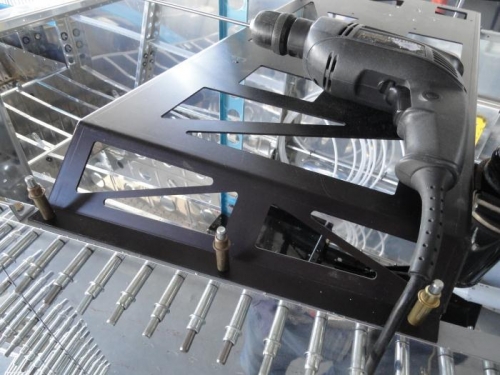

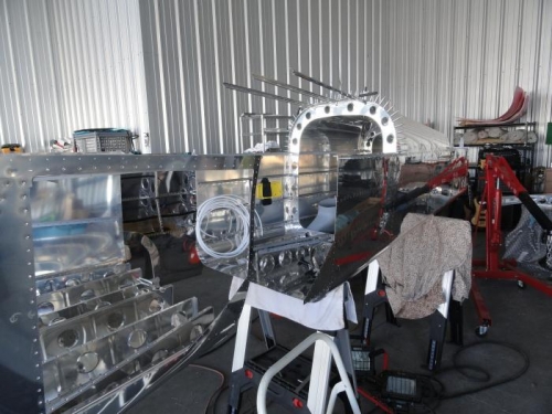

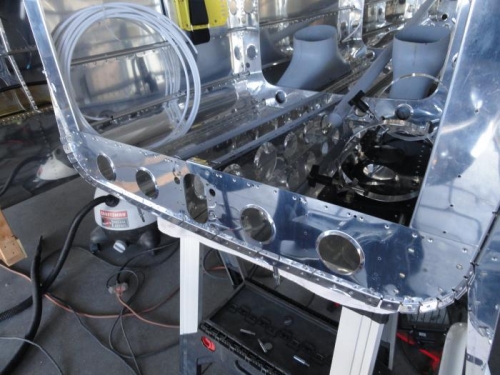

Brief Description:  Dimple and prepare fuselage for join
First I drilled the package tray for the air conditioning unit to the longerons. Then I un-clecoed everything and split the fuselage. With the fuselage split, I marked and drilled the openings for the air conditioning hoses and the static line through the bulkhead. Then I dimpled all the skins and the bulkhead, trimming in a couple of places where the bulkhead met interference. Once everyhting was dimpled, I assembled the bulkehad and riveted it together. Then I rejoined the fuselage and clecoed it all together.
