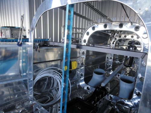

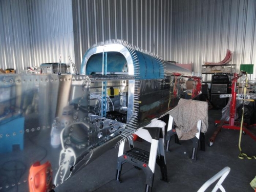

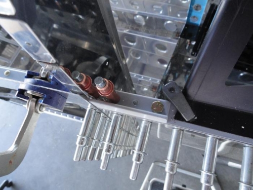

Brief Description:  More fuselage mating work
Drilled the bolt holes through the foreward and aft longerons and installed the bolts temporarily. Made the shims to go alongside the longerons under the top skin. Located the package tray for the air conditioning unit and then installed the top skin. With the top skin in place, final drilled the left longeron and around the baggage compartment. Will be drilling the rest and countersinking tomorrow.
