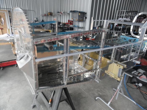

Brief Description:  Riveted left substructure together

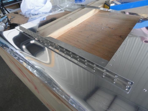

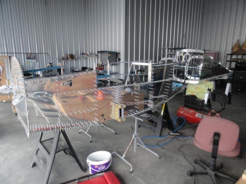

Backriveted the floor stiffener and shims at the baggage door opening. Then began riveting with the seat back rail and worked forward on the left side. I used a combination of squeezers, including the longeron yoke with the pneumatic squeezer, and gun to reach some difficult rivets. When all the structure was riveted, I clecoed on the left skins in preparation for riveting.
Rivet count: 136 Total: 11369 - Plus 549 done at Van's
