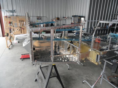

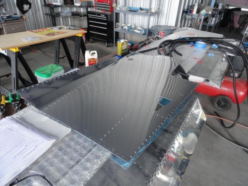

Brief Description:  Prepare left skin and structure for riveting

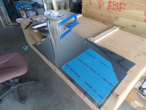

Countersunk the remaining left side parts and dimpled the thinner ones. I had to create an extension for the countersink cage to get close to the wing spar; I used a conduit cutter extension and cut it down to about 18". After all the structure parts were done, I dimpled the left side skins. Finally, I cut out the baggage door opening.
