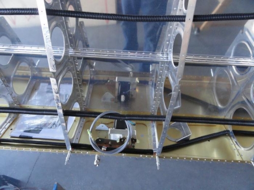

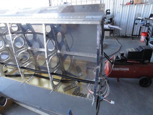

Brief Description:  More riveting, pulling right wing wiring

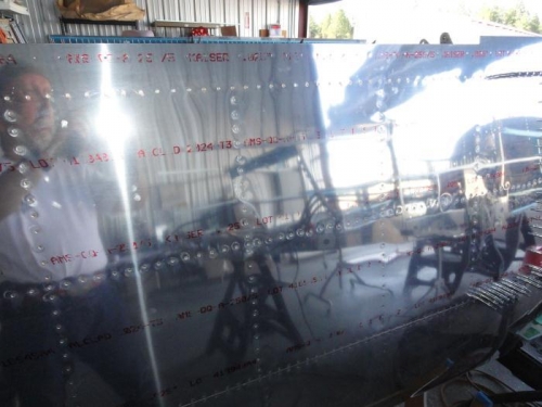

Installed the conduits and pulled the wiring harnesses for the right wing. The main harness is larger than the left, so it was a tight fit. The magnetometer harness for the GMU-44 ends one bay inboard of the tip for maximum distance from lights and roll servo.After wrestling with the harnesses, I ended the day by riveting the aft row of rivets corresponding to the work already done on the top skins.
